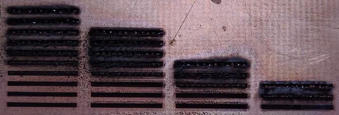

**Post date:** [July 14, 2024, 7:18pm UTC](https://forum.snapmaker.com/t/2w-laser-first-test-pcb-does-work-with-restrictions-slow/36372/5 "2024-07-14T19:18:06Z")
OK, I ran a test pattern file, using Lightburn’s Offset fill with 0.02mm line spacing to laser 0.5 x 10mm lines into the PCB board. The pattern is:
- 200 mm/min, 1-10 passes
- 150 mm/min, 1-8 passes
- 100 mm/min 1-5 passes
- 50 mm/min, 1-3 passes
To me, 150 mm/min 4 passes gives the best result, and I’ll try the isolation test with that one soon.
Here are the photos:
- Right out from the laser:
 ![grafik](https://us1.discourse-cdn.com/flex022/uploads/snapmaker/original/3X/a/2/a2e5fa6d69c6e6cbdcf8a92c9973f07bcd05db9b.jpeg)
- After polishing it:
 ![grafik](https://us1.discourse-cdn.com/flex022/uploads/snapmaker/original/3X/f/7/f7ac30928371d80929677bafbc51043c0a9fe432.jpeg)
- The backside (mirrored to make comparison easier):
 ![grafik](https://us1.discourse-cdn.com/flex022/uploads/snapmaker/original/3X/b/d/bde03b9282330798ae1f363bd18a29f85dac0837.jpeg)
If you open the polished image in 100% view, and look at the 150 mm/s 2 and 3 passes line, you can in the middle see an incredibly thin line of copper. Now remember that the line spacing of the laser lines is 0.02 mm! This shows how incredibly fine the laser focus point is!
EDIT: Just realized that when looking at an angle you can better see where the copper is gone, and where it still has some thickness:
 ![grafik](https://us1.discourse-cdn.com/flex022/uploads/snapmaker/original/3X/9/e/9ead5d4176526cb18942e627391f4873f975db20.jpeg)
EDIT EDIT: I guess I’ll do a bit more testing - mainly going even faster and more passes. Remebering the video that @buckfast_beekeeper mentions, they also do many fast passes, which I guess may limit the thermal stress to the carrier material. And it is obvious that this gets scorched by the process.

Hi.
The resistance you measure after isolation is most likely the carbon formed by the burnt fiberglass substrate “connecting” the two areas.
**Post date:** [July 15, 2024, 5:09pm UTC](https://forum.snapmaker.com/t/2w-laser-first-test-pcb-does-work-with-restrictions-slow/36372/8 "2024-07-15T17:09:21Z")
Yeah, that’s my assumption also.
And that’s why I now am going down the road: Fast laser movement, many passes - and that seems to be better, the substrate not getting _that_ burnt. I now achieved ~1 Megaohm by going 2000 mm/min, 50 passes, and I guess 45 passes would have been enough. So slowly getting there… hopefully.
Of course it may also depend on the substrate - I am not 100% sure, but I’d guess the scrap piece I’m currently burning down is epoxy based, and I’d have thought that this should be somewhat laser resistant. I’m surprised how much it chars. Perhaps it is paper based after all?

**Post date:** [July 21, 2024, 2:51pm UTC](https://forum.snapmaker.com/t/2w-laser-first-test-pcb-does-work-with-restrictions-slow/36372/17 "2024-07-21T14:51:19Z")
OK, test run finished. For my 35µm copper layer, phenolic paper PCB the sweet spot is 500 mm/min, 15 passes, 0.02mm line spacing… Going slower with less passes causes soot/charring and is not good. Faster and more passes is OK, but I consider less passes as more efficient.
My second Epoxy PCB was no good - so epoxy-based is out for me.
This is painfully slow in the end… the effective speed is ~30 mm/min, and if you want to have 0.2 mm isolation width (which is not much), you’re down another factor of 10, i.e. 3 mm/min effective isolation routing…
Whatever, my next step will be to do a real PCB circuit, and see how fast it is in the end. I guess I’ll create a new thread then, also going through my workflow.
happy and not happy at the same time 🙂
