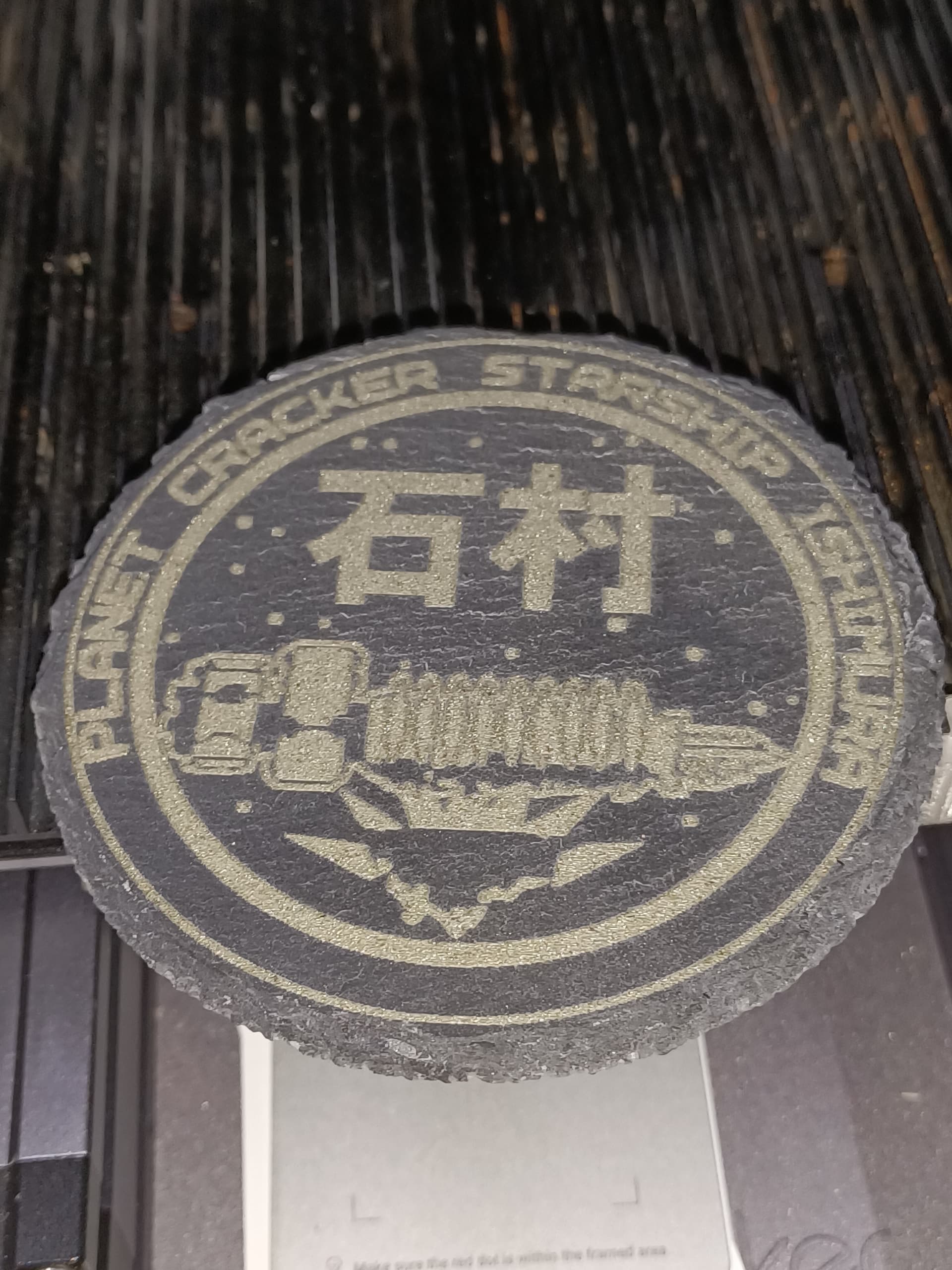

Finally got around to testing some slate with the 10W. Done at 2000mm/m, 100% power, 0.1 interval.
 ![PXL_20220803_233111979](https://us1.discourse-cdn.com/flex022/uploads/snapmaker/original/3X/f/9/f94fe6946abdcd3dfadeef9a1bc6ad5007e41e31.jpeg)
Slate lasers REALLY well. 🙂

Was going to try some myself soon. So the lasered part comes out ‘whiter’ than the base color? Just want to plan my designs right (invert or not).
Assume I can ‘grayscale’ with rastering, with the unlasered color being darkest?
**Post date:** [August 23, 2022, 10:54pm UTC](https://forum.snapmaker.com/t/10w-slate-coasters/26912/4 "2022-08-23T22:54:39Z")
Yes, the laser part becomes lighter. You’ll have to invert your images for them to appear correctly.

With mineral oil it seems to work fine still for condensation. (In So Cal, so not crazy humidity)
I wouldn’t worry about wear damage. It’s pretty darn permanent. Although if you make a mistake you can use wet sandpaper and sand off the marking and redo it. But it takes a lot of elbow grease to get it off.
As far as grayscale goes, you’ll want to use dithering. Unlike wood where you can get different shades/levels of burn, with slate it’s pretty binary - one level of white/gray.

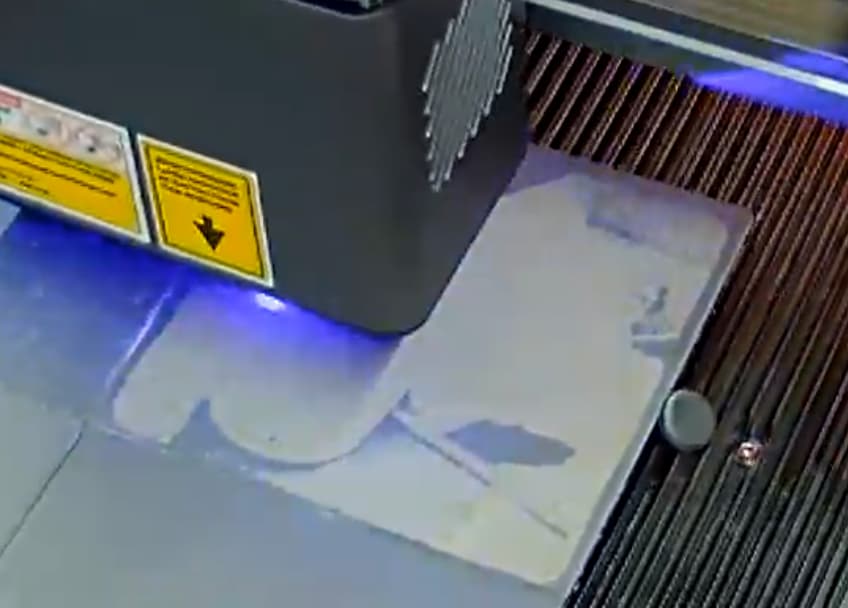

I’m just about to start a laser job using the 10W on slate and I’m super confused by the values presented here 😃
Are you guys using 100% at Work Speed 2000mm/min
or Job Speed 2000mm/min?
I see op mentioned infill of 0.1 which probably means he’s using dot-filled?
I usually don’t bother with that as it takes way too long so I’m using line filled at 0.14
which I found through some tests to cover the surface quite well without looking stripy

Ah awesome thanks! 🙂
Unfortunately looks like mine aren’t gonna work out
 ![Bildschirm­foto 2023-04-07 um 14.29.06](https://us1.discourse-cdn.com/flex022/uploads/snapmaker/original/3X/3/4/3416c0cc776e6906d700963590eb34a3e5f04950.jpeg)
This is what my print looks like so far and
 ![Bildschirm­foto 2023-04-07 um 14.30.11](https://us1.discourse-cdn.com/flex022/uploads/snapmaker/original/3X/f/b/fb7183d946bde47b02f11122bc14bc79aee61319.png)
Thats what it looked like in Luban before printing 😕
Guess the contrast is far too weak I thought from what I saw online that gradients could work but guess not the print looks like it was all done with the same strength
Copied your settings btw just kept line density at 0.14
**Author:** ![Dinkelborg](https://sea2.discourse-cdn.com/flex022/user_avatar/forum.snapmaker.com/dinkelborg/32/7228_2.png) [@Dinkelborg](https://forum.snapmaker.com/u/Dinkelborg)\
**Post date:** [April 7, 2023, 2:02pm UTC](https://forum.snapmaker.com/t/10w-slate-coasters/26912/20 "2023-04-07T14:02:52Z")
Just took them out and they are completely ruined, there is no nuances it just burned the entire area just like the first picture suggested.
I also noticed the surface to be raised now and its tinted yellow. From the smell, the crystalline structure and the smell of rotten eggs they released when I started to sand the surface, I would almost think that somehow the burned areas are covered in sulfur crystals.
I’ll try and spray them with some bathroom mold cleaner as that contains chlor and might dissolve the sulfur if it it sulfur …
Overall I noticed that when sanding them, a lot of details and even the font did show up underneath the top layer but once you sand it down to that, the details get damaged beyond repair. I’m now trying with 50% power but so far it looks identical to the one above
